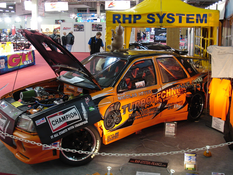

my car is a sierra cosworth 1989 trophy series
i buy stock
now it's 524hp with bio ethanol
Engine modifications
Forgets WRC Pistons
H Rod
Programmable injection
840cc Injectors
WRC Camshaft
WRC Cylinder head joint
200 engine bloc
Water injector
Stainless steel collector
External waste gate hks gtII
Turbo garret gt 3076r
Frontal aluminum intercooler
Stainless steel 84mm line
Triple fuel pump
body modifications
18 inch wheels
265/35 rear tires
235/40 front tires
Adjustable suspension
Roll cage
Harness
330mm front breaks
Wide bodykit team made
Carbon wings
carbon dashboard team made
carbon seat
Lexan windows
lsd

Not my cup of tea, but some good work gone into it
Whats up with the position of the wand tho? :S

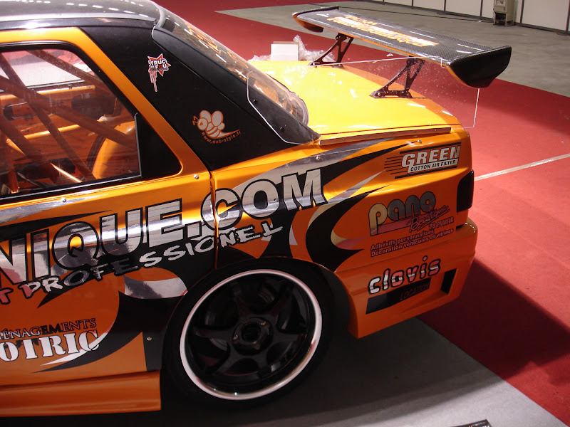

whats with the plexiglass between rear wing/fender to spoiler?
love the car though!!

Whats the perspex for on the rear???

it's deflector for not spin in hight speed switch back

Hydraulic handbrake
whats it mounted like that for? it looks as tho you will have to push it down towards the floor to make it work?

yes for work i kick down but it's a personal technique and i have trouble of fuild now it's normaly pull As in rally it's vertical.
