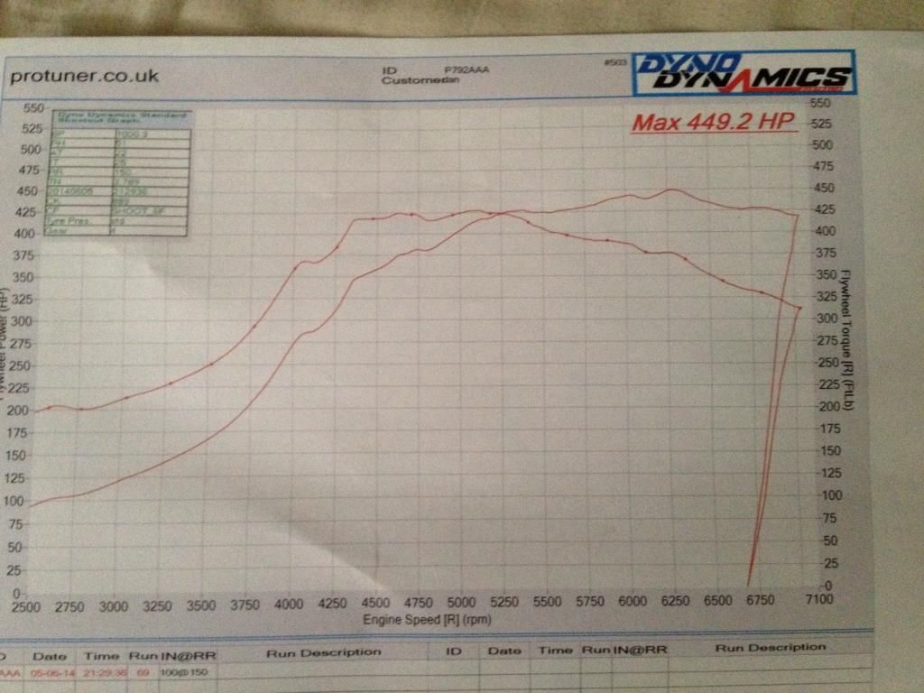

    674
    Big thanks to Greg for mapping the car made good power and feels spot on to drive.
