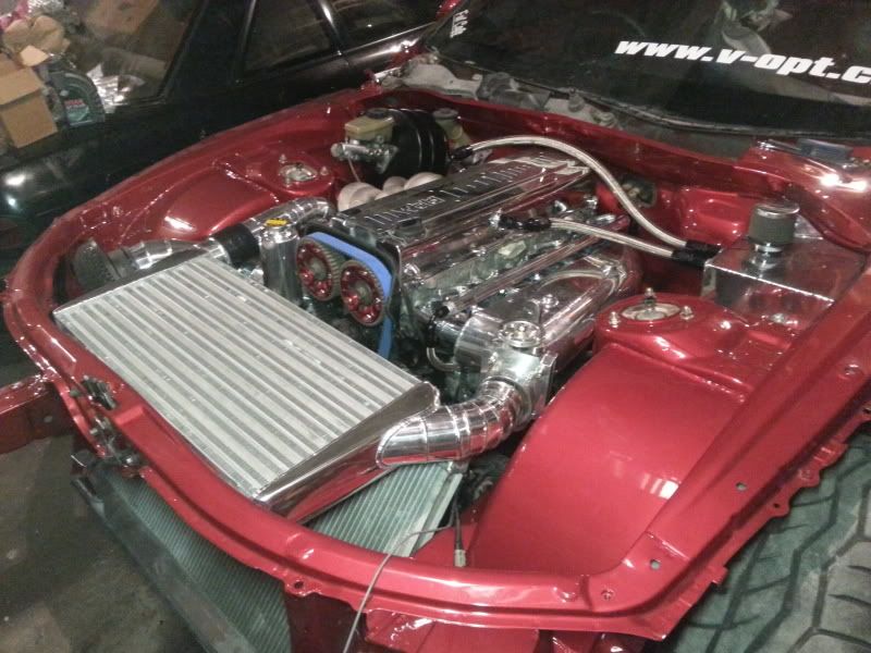

    teaser of paint. getting actual pictures taken tomorrow.

    That exhaust manifold is on the bat-shit-crazy buzz, looks awesome, like fingers or some shit, love Racefab's work. I freakin' hate Soarers but I love the detail work you've done here, looks miiiiiiint!

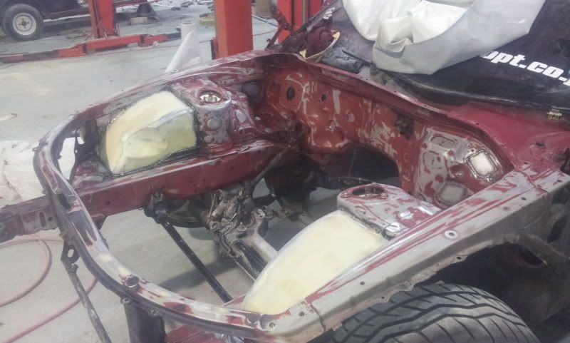

    cut out the boot floor..

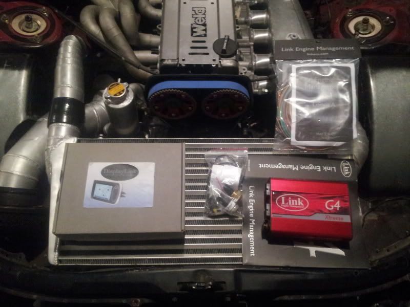

    bought a flashy ecu

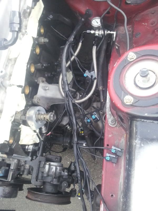

    made up engine loom. its completely heatshrunk. what a mission that was.

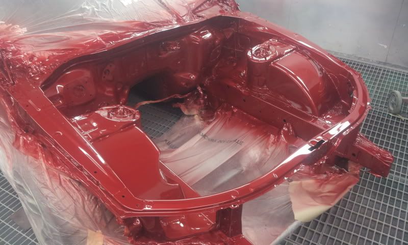

    now had to prep and paint...one of my mates dented the rear gaurd so had to fix that
    prepping engine bay

    Did the ECU/loom come with those new plugs? Got to make my own loom aswell.

    the ecu simply came with the wires. all 3 sensors came with their own plugs (air temp, map sensor and oil pressure) the new coils and injectors came with their own brand new plugs too. the only re-used plugs in the whole engine loom are alternator excitor, water temp, crank and cam position sensors and a throttle position sensor from a nissan leopard and that is literally the whole engine loom.
