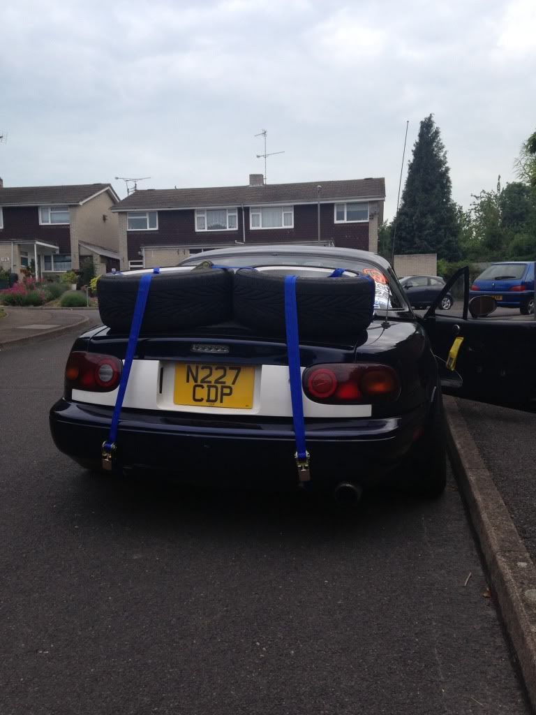

    I took 4 tyres with me, 2 on the boot lid, 1 in the boot, 1 on the rear shelf and still had room for tools, fluids and a passenger.
