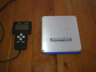

    So I was just messaging around looking for any nice parts on the market and came across a Apexi Power FC and Hand Commander for the RB25det!
    Can't wait to get the car back to John at West Coast Performance (WCP) for setup and a run on the Dyno! Anything Jap and John is your man. The results speak for themselves mapping most of the top cars in Ireland and Europe such as James Deanes & Nigel Colfers Drift Allstar weapons.
