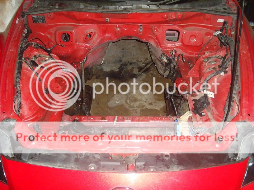

    Did a bit more ripping, took out all the pedals, master cylinder and abs unit...
    The engine bay is starting to look alot cleaner, except for that monstrous loom !

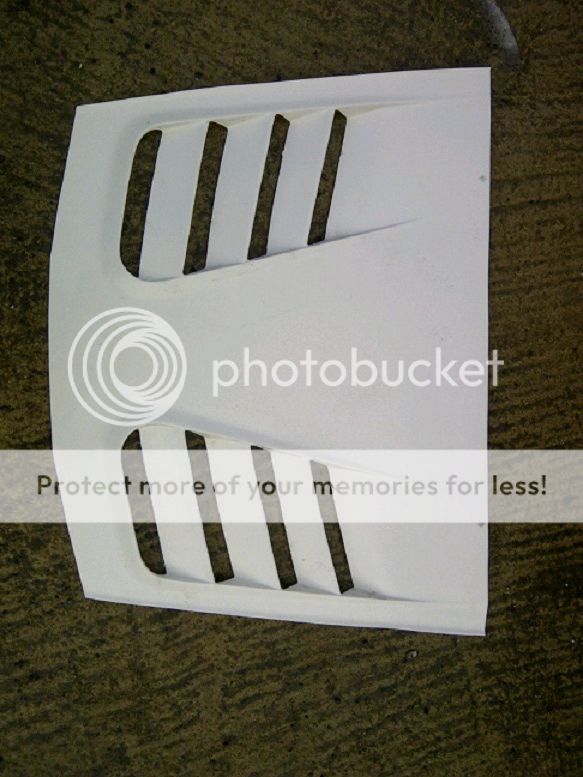

    So just a small update, I was onto Brian in Driftkits.eu and looking for a vent to build into my own bonnet, so he cut up an S15 skin he had in stock, legend ! Looking forward to fitting it once it arrives ;)

    Finished removing all the glue with petrol left over from the sound deadening, took off the heat cover under the bonnet, lined up the vent and have it ready for cutting tomorrow :)
    Weird looking bonnet...
    Everything outside the masking tape is now waste, will have to fit the vents seperately to avoid the standard dip in the original bonnet...
