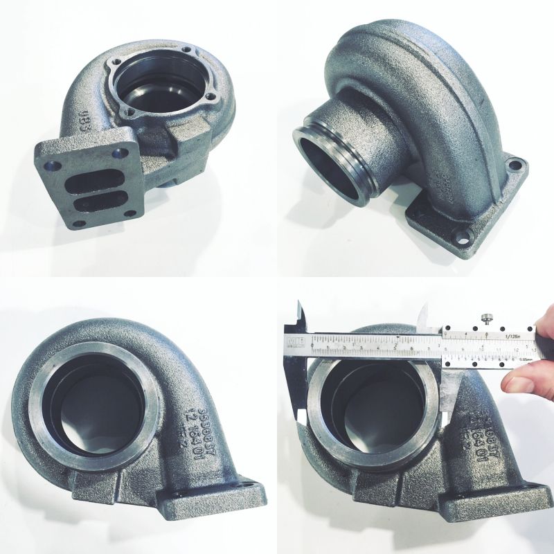

    No, HX40s have bigger turbine wheels than HX35s, so not a straight swap. Ignoring the wheel, the housings do bolt on though, so you can machine the HX35 housing internally to fit a HX40.
    In other news, Compressor Racing have some cool Holsets at the min, inc non-wastegate HX30s with the bigger compressor- People were seeing 370lbft+ at 1.3bar on stock SR20s a good few years back on here when a few people tried them.
    NEW- Holset HX30 quick spool 350bhp T3 turbo. HX32 HY35. Not GT28 T34 T3/4 T28 | eBay
    They got HX50s and a HX60 too if anyone wants to get mental lol.
